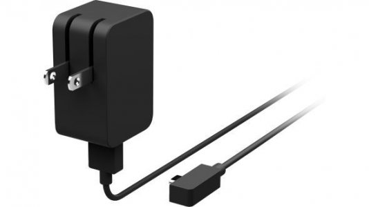

Hey folks - digging the Surface 3, just need a longer power cord.
Did some quick searching, no joy - anyone found one? Thanks!

An extension is probably the way to go. The issue is the power supply. I used a longer USB cable with a garden variety USB 2-prong plug and it didnt charge.

Sometimes the low tech simple solution is hard to beat. Although I have an Anker 10ft cable and it works for me but you don't get the right angle connection.

Ahh, works for a SP3 but not a S3 the little power brick plugs straight into the outlet.

Yeah, I'm an idiot, sorry. I forgot the cord is not hard wired into the power supply. I'll just buy an angled, longer USB->Micro USB cable. Duh.

I do actually have my S3 brick at home plugged into an extension cord. :)

Do any of these charge while you're using the Surface 3?
I have a million long cords, some are the thicker version, but the only one that doesn't give me the "Plugged in Not Charging" when I'm using it is the Microsoft supplied cord. At $30 a swing, I'd really like to find a good alternative.

Hi toujoursdan and others. Well this was my biggest issue with the surface 3. & i have fixed this issue, according to me .Here is what you need to do. Find a Large sized AWG microcable. Preferably 20AWG. You can find them on ebay for as low as 2.00$ USD. search ebay for 20awg micro usb cable. GOOD LUCK ALL !
fastordiy
20awg micro cable im telling u thats what you really need.(charges just as fast if not faster than the oem microcable.
