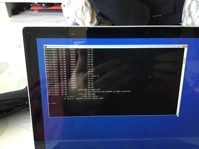

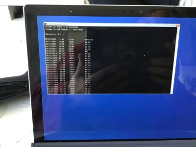

Sorry for delay, busy at work and home, I think we have had some success. How do I proceed?

Hi, have done this and posted pictures of result. Any further help you can give would be appreciated.
The C: drive on a Windows computer is the default primary partition where the Windows operating system, along with your installed programs and system files, is stored. However, based on the images you provided, it appears that the C: drive is showing the contents of the USB recovery drive.

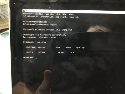

Let's take a different approach and list the physical disks that are available.
1. Repeat steps 1 through 6 from above.
2. When the Command Prompt appears, type "diskpart" and then press Enter. This step initiates the DiskPart command interpreter and changes the prompt to DISKPART>.
Next, type "list disk" to display all available physical disks. We want to see an image similar to the one below, where Disk 0 represents the system or boot drive, and Disk 1 represents the USB recovery drive. Please take a picture of your screen, and let's have a look at what appears.
Not quite the same as your photo? Look forward to your reply.
The image shows that only the USB recovery drive is available, so the absence of the SSD as an available disk likely points to a hardware issue. Repair options are limited since the SSD in the Surface Pro 6 is soldered in place, but there may be something upstream of the SSD that is causing this. The only thing I can think of at this point is to disassemble the device and carefully retrace your steps.
Will try that thanks, shame as previous did show list for C drive
