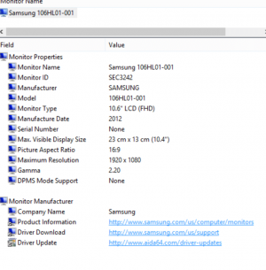

Can you get AIDA64 Extreme (http://www.aida64.com/downloads - trial version is all you need), once installed on your Surface Pro 2, can you go to (in the program), under Display > Monitor section. It should give you the monitor name, monitor ID, and Manufacture.
Can you give them to me?
Here you go @goodbytes It's a Samsung panel built in 2012!
