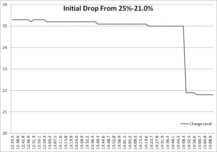

I have a replacement SP2 that I am putting through its paces before I send the old one back. It has been fine, but it still seems to exhibit some of the anomalies of my original unit. Specifically, the battery level will spontaneously drop from 25.0% to 21.9%. Since both machines exhibit his same behavior, I am will to chalk it up to weirdness by design.
So, I decided to perform the Feb update. I first did a system refresh with the modified image (Jan drivers and 3368 display drivers) - I wanted to make sure that it worked while I had both Surfaces in my possession. After the refresh, I performed a windows update and all the updates successfully installed (including the firmware).

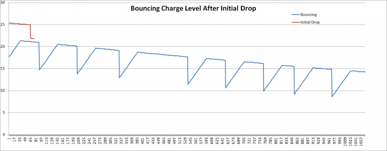

And now for the really weird part. Since this new update is supposed to improve the battery reporting, I decided to see what happens when it hits 25%. Sure enough, it dropped to 21.9% as it always had. But, then it dropped again to about 15% at which point, over the next minute, it crept back up to about 21.3%. It then seemed to discharge normally. Hmmm.... Just a I am writing this, I noticed the the battery was at 14.0% and the it again started to climb to 16.3%. I actually logged this behavior with hwinfo. Now it dropped to 10% (giving me the battery warning) and bounced back to 16%. This is really strange. And now down to 9% and back up to 15%. EDIT: I just restarted and the "yoyoing" seems to have stopped for now.... Drat.. never mind... just dropped to 6% and went into hibernation.

Prior to the firmware update, I had only run down the battery to below 10% two times. Both times it would start hibernating at 8% (instead of 5%), which is the same behavior that I experienced with my original SP2. This is the first time I have run down the battery after the update and the "yoyo-ing" started once it dropped below 22%.

I figured that some visual aids might be useful
C'mon, I can't be the only one with these issues. At the very least there must be more people with this mysterious drop at 25%-22%. After all, both SP2s that I received exhibited that behavior. I can only surmise that the presence of that drop is causing the new firmware to freak out when it is encountered.

Looks like I have to offer a correction. It just happened to me to on the latest firmware update. Once it gets around 25%, it drops to 22%, then to 14%, then back up, then down, etc. It doesn't seem to affect my overall battery life (I'm still getting power as if it were counting down from 25%). I definitely see how this can be a bigger problem if you're hibernating earlier than you should (I have mine configured to hibernate at 6%). You can also go into power setting options and turn off notification of low battery level (you're still notified when you reach critical level), at least as a temporary workaround to get rid of the messages.
Well, I am glad that I am not alone...Did you notice the 25% to 22% drop before the update? Both of my SP2s had this drop from the beginning. I guess it is easy to overlook if you are not looking for it.
The problem is that the level actually drops below any set hibernation threshold. Mine is set to 5% and the level starts to dip to 2% or 3% which initiates hibernation. When I wake it up, the level will rise to over 10%. I find that it is basically unusable below about 15% due to drop induced hibernation.

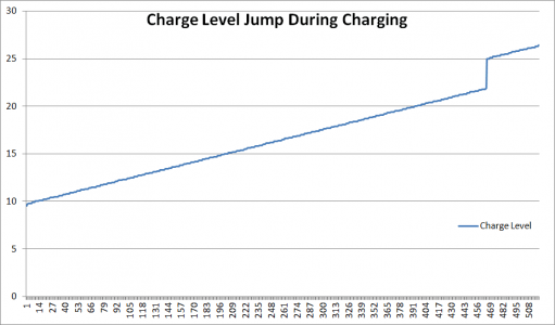

Yup. The battery capacity returns to normal during charging. The graph I posted of the battery charging shows a nice linear increase in the battery percentage, until it hits the wormhole located at 22% and it abruptly jumps to 25%.
