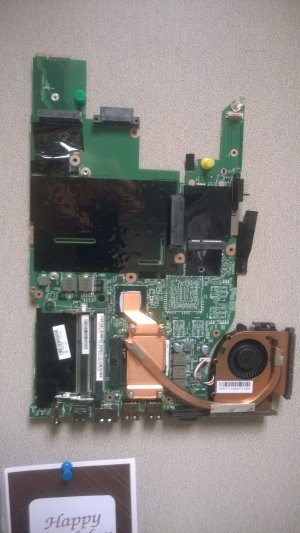

While the heat pipe in the SP3 is probably one of the thinnest examples the tech isn't anything special. Just about every notebook on the market has something similar just on a larger scale.
Water generally doesn't need evaporation. I wonder if they tried other coolants.
Kind like this one hanging on the wall of my cubical at work.
