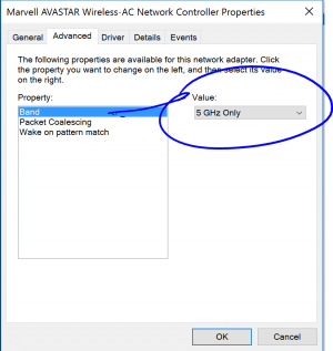

Your English is really good! Anyhow, try this - Change the settings on your Surface Pro's WiFi Network Adapter to 5 GHz only. Once done, even though you don't have too, reboot your SP4. Then reconnect to your network and do a Speed Test. Keep in mind there are many variables when using Speed Test Software. Make sure you use a speed test that will allow you to specify which region you are currently in. One that I use is - Speedtest by Ookla - The Global Broadband Speed Test .
If you need assistance on setting your Network Adapter to 5 GHz - see the attached picture - If you change it and cannot connect, don't panic, just change it back to the original settings which in most cases is "Auto". I have found that setting my Network Adapter to 5 GHz has cleared up many issues, mainly speed. Hope this helps you out. If so - let us know. Thanks.

Hii Mikeman,
Thanks for your reply, this helps alot!
Now I can browse and download with a good internet connection :)
