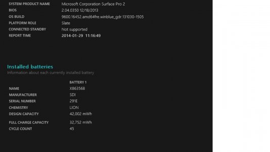

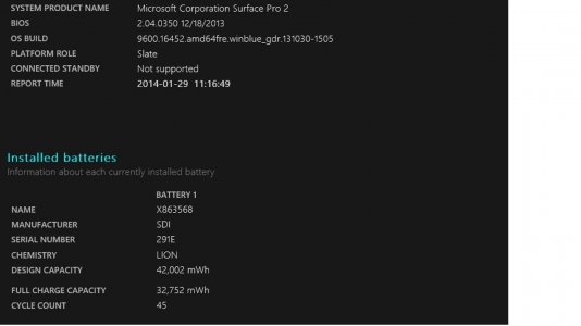

This is the powercfg screen capture right after (volume +key with power button) boot
Check Full Charge Capacity

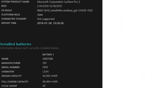

This is the next charging captrue
Everytime I restart Full charge capacity is chaging....
It seems 40,404mWh is normal charging cpacity.
but most of time Full charge capacity is set to 20,000 ~ 30,000
Is this Firmware problem? or defect SP2...
