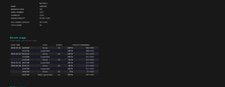

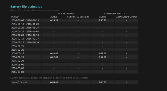

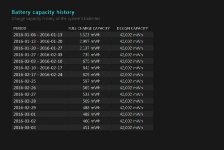

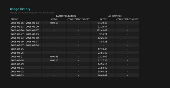

Warranty exchange, which obviously you can't even do that. At this point, do a full restore on the device, and ensure it's up to date. If none of that works, you're likely just looking at a bad battery. How many charging cycles do you have on it ? have you already ran a battery report ? Open cmd and type powercfg /batteryreport
it'll open a browser, take pics of that screen and paste them here please.
OK, Here are the screen shots
