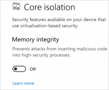

Settings > Update & Security > Windows Security > Device Security > Core Isolation is greyed out.
Being admin I can't disable it (Core Isolation), being necessary for a Photoshop CS6 install.
Any suggestions how to solve this?
Thanks!

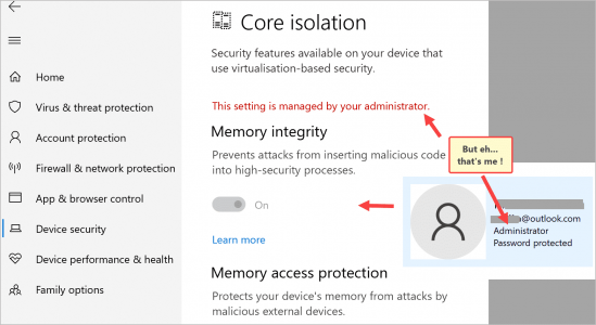

Thanks for your reply. I am an 'individual' user and have admin rights on this device. It is a 'long shot', but I suspect... that it might have something to do with the following. At startup there are two users to select from, my wife and me. Same PIN code by the way. I have just some other stuff added to my environment.
I just checked: within her account Core Isolation is also greyed out. Account type: standard (i.e. non-admin).
Later..
Found the solution on Technet at: "This setting is managed by your administrator" can't turn ON Memory Integrity
HKEY_LOCAL_MACHINE\SYSTEM\CurrentControlSet\Control\DeviceGuard\Scenarios\HypervisorEnforcedCodeIntegrity, Enabled key,
Change from 1 > 0
Computer\HKEY_LOCAL_MACHINE\SYSTEM\CurrentControlSet\Control\DeviceGuard\Scenarios\CredentialGuard, Enable key,
Change from 0 > 1
After rebooting this setting was 'ungreyed' indeed... :)
