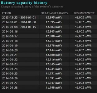

I just ran a powercfg /batteryreport and the results show:
DESIGN CAPACITY 42,002 mWh
FULL CHARGE CAPACITY 40,567 mWh
CYCLE COUNT 23
is this normal? Seems I've lost 5% of my battery capacity over the last month. It also counts 23 cycles. I know I have not drained my SP2 down to 0% battery before. Where does the battery typically count a full cycle?
I was under the impression that most laptop batteries will drop down to 80% their design capacity after around 300 cycles. That's 20% loss after 300 cycles, not 5% loss after 23 cycles...

So basically my battery capacity died after the 12/18 update. This is just silly
I'm down to 40.071 mWh after 61 cycles.
Not sure what a normal drop in battery capacity is after a couple of months of use.
Same here. Every time I perform a battery test, it shows a different capacity. Sometimes it shows 40.000 mWh, sometimes 38.000 mWh...

Here's my information just in case someone is interested. I think it's doing pretty well.

I've been monitoring my battery after installing the Jan. 18 firmware and found my battery full charge seems unaffected. There does appear to be some variance from day to day. Here are all of my full charge values which covers 11 full charge cycles according to the report:

typically a battery should retain 80% of it's design capacity after a year or so. At this rate my SP2 will be at 80% in a matter of months...
FWIW I've been noticing similar fluctuating values in full charge capacity, which are hard to understand, how it's calculated isn't really clear.
It's also confusing how "cycles" are determined. The battery in my SP2 has been drained almost to zero (down to ~10%) well more than 4 times, but cycles reported is still only 4. Maybe that's right, but then what the heck is a "cycle"?
Oh well, not too much to do about it anyway--the battery is certainly not user replaceable. If the SP2 battery doesn't go the distance, we'll have to chalk it up to design failure. Time will tell.
