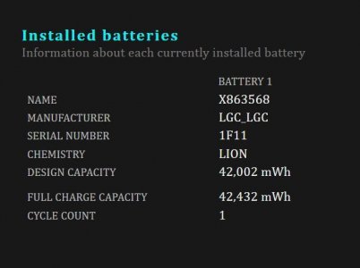

Mine is abyssmal, wtf
I got about 3 hours this morning
Information about each currently installed battery
BATTERY 1
NAME X863568
MANUFACTURER SDI
CHEMISTRY LION
DESIGN CAPACITY 42,002 mWh
FULL CHARGE CAPACITY 25,685 mWh
CYCLE COUNT 29
