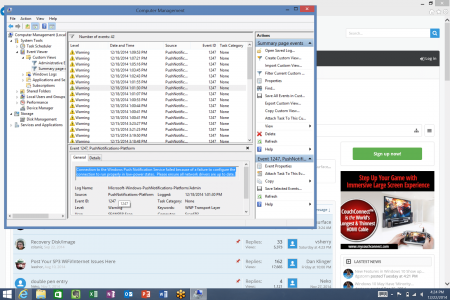

Take a look at this screenshot of my event viewer. The error of push notifications had popped up many times. I checked the driver for this, but it's up to date (Marvel Chip I believe)...Thought this might have something to do with it. Wondering how to check if all my drivers are up to date easily? I did last firmware and all others so believe it should not be an issue. Who knows

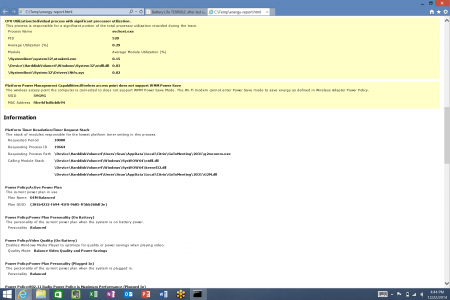

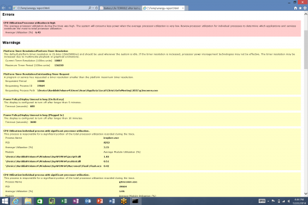

I run an energy report and took screen shots of the report since I could not post it directly. I am hoping someone can tell me or interpret what is going on here because I don't fully understand what the issues are and how I can resolve them.
Thank you

I suppose the first energy report can be disregarded because there was a process consuming CPU. I also have the "access point does not support power save" on my energy report but it isn't an issue because I used the SP2 with the same router and it worked great.
My energy report is mostly clean and I still have the battery issue.
GoToMeeting program is not playing nice with SP3. Try uninstalling that first to see if your situation improves. Also, run sfc /scannow from an elevated prompt to make sure files are not corrupted. It look likes a dll library may be causing some issues.
