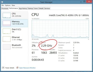

I've noticed that my SP2 4200U device reports in Task Manager a constant speed of 2.3 GHz. In any default power mode, plugged in or on battery it always reports the same speed (circled in the attached image) Is this right? I thought it was supposed to step down and/or burst depending on demand. To test the upper end of this, I've opened every program I have and pegged the CPU at 100%, still no movement past 2.3Ghz.

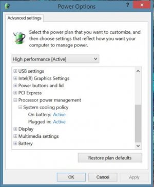

There are no such options on my device:
The lowest I've seen is .76 and the highest was 2.35 GHz.....do you have all of the Firmware Updates? Or is your system managed by a Domain? You missing 2 additional settings.
I have every firmware update and its not on a Domain

Yes, I'm running the Hyper V role. Does this disable stepping or just the reporting of the correct CPU speed?
EDIT:After some research I've read that its just the reporting of the actual CPU speed when Hyper-V is installed. Stepping still occurs as normal but not visible in Task Manager
