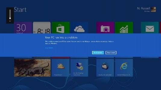

I < thought > I had the original problem solved --- but it's back.
Seems it booted up a couple of times and then I saw the same old error message again.

Does it look like this
If so, go to Control Panel/Hardware & Sound/Device Manager. Expand Network Adapters, right click on Marvell Avastar, and select Properties, then click on Power Management. There is an item called "Allow the computer to turn off this device to save power." If that box is not checked, check it, then do all the Ok stuff.
If it is checked, let me know, because that means I am remembering the wrong thing.

Yep, that's what it looks like.
Went into Device Manager and the Marvel is not listed. It shows a problem with Avast Firewall NDIS Filter Miniport. Aarrgghh.

Willie --

Whoops, I get to switching back and forth and forget which computer I was looking at :)
That big error with the virus program is on this desktop ... just did what you said with the Marvel adapter and checked the box and it has restarted 3 times ok.
Once with the keyboard attached and twice without.
I hope it continues. :)
