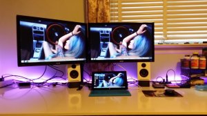

Awesome! Glad to hear your DP chaining works well. I'm actually just using a USB video out adapter + DP for my setup. I agree that there isn't a noticeable degradation in quality from the USB video which s awesome. It's even connected to USB hub that is powering an external dvd burner, 1TB HDD, wireless dongle, and a SD card. No lag whatsoever!
Here's a pic of my setup haha (excuse the wiring, i'll fix it later)
