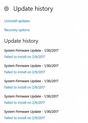

Thanks for trying, Greyfox7, but that did not help at all. I have attached a snippet of my update history to show that it is not installing. I am getting error 0x800706be.
Does anyone have any other suggestions?
