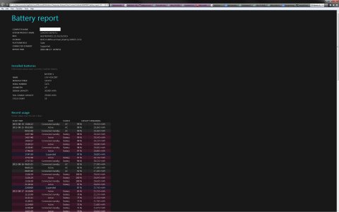

powercfg.exe -batteryreport You dont need the spreadsheet unless you want to dump this data into one. The report dumps into your profile.

As for powercfg.exe, I found a few of those applications in my file explorer. Not sure which one to use. Plus clicking on them flashes black box then disappears. Can't find where the info is dumped to like machistmo showed.
Its in the root of your profile. c:\users\%username%\battery report.html
