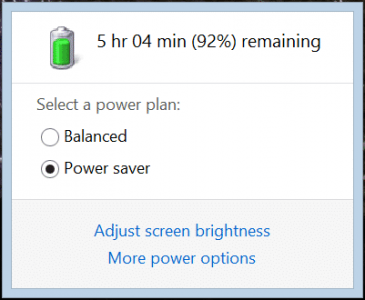

Just used my SP2 on a train for the past 45 min from 100% battery using my tweaked power saver profile that caps the max CPU speed to 75% and 25% screen brightness while tethering to my iPhone 5 (Edit: I was mostly reading a pdf in Drawboard PDF and writing in Word 2013):

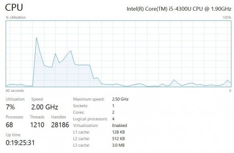

I just tried it and I didn't get the problem. It went into hibernation... pushed the power button to wake it up... the task cpu spiked to 40% or so for a few seconds... then it resumed as normal. I was just running Chrome with 3 tabs open. 64GB SD card is in. You can see the spike below:

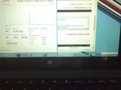

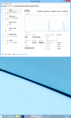

What I'm running, whether active or in background, right now is Metro IE, Desktop IE, Mail, Bing News, Adobe Photoshop (old version), Store, News Bento. Adaptive Brightness off. Keyboard is attached throughout (LED lights are set to off), though mostly folded back when in Metro. Nothing connected to USB. Pretty much the default processes running at startup. For the lock screen, I'm running Mail, Calendar, Alarm clock, a Wifi meter app, and Viber. On the Metro interface, I have 7 apps running Live tile. I'm on the Balanced power profile, continuing my test from yesterday. CPU Processor is set to 5% minimum, 100% Maximum.
Sorry for the crap image, I can't figure out how to take a screenshot on this thing (god I miss Prnt Screen). Also, it's been running for almost an hour (no sleep or screen turned off during that span), and it has 90% battery level. It was also cold booted, with an SD card inserted, and had no substantial CPU utilization running at startup. I have a high quality card, though no idea if that plays a role.
EDIT: Attached my iPhone to upload the picture, and it has a voracious appetite. Had it connected via USB for about 3 minutes, and it sucked 3% of my battery in that span!
EDIT 2: I have now used it almost continuously (let's just say I'm now well versed on today's current events!) for 8hrs. and 37mins on the Balanced profile, and I still have 26% battery remaining. This concludes one aspect of my test, in that I was able to replicate the longer battery life, which is over 2hrs more than what I was getting from Power Saver. Since I have that profile configured for maximum power savings, this leads me to believe that one or more of the settings utilizes more power when set to its lowest power option, or the profile itself is bugged in some other way (at least on mine).
