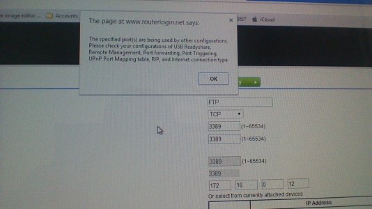

I am having trouble again :( this after the latest update.
It wont let me use the 3389 port. Its saying the port is being used by other configurations. Help please!

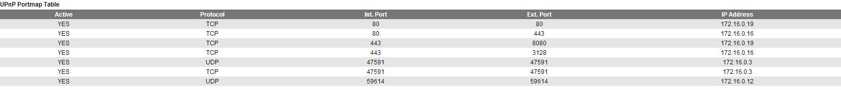

netstat.JPG this is what comes up at the cmd find 3889
cant understand it thoughj
Assuming that was ran on the RDP Target (Host), It means your machine is accepting RDP on 3389 and if the other screen shot is your router I don't see it accepting RDP on 3389....
If I try to change the port on the router to 3889 it won't let me. It gives the error on that other screenshot.
You are confusing Remote Management with Remote Desktop, you will need add an entry for RDP then you can assign the Port.
I did. Tried adding RDP, with TCP service, then placed 3389 on both ports but get the error that the port is already being used. I used the exact same settings before without problems.
The only thing I could think of that changed at our home is that I have since installed network web cams.
