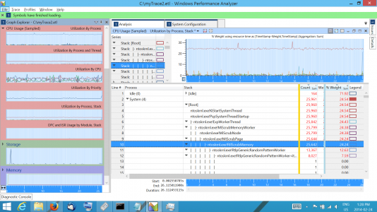

I have done a little more digging. I downloaded the Windows Performance Toolkit and recorded a trace with xperf. The culprit seems to be the kernel function RtlScrubMemory. This seems to be part of memory maintenance that occurs during idle periods. For me, this is running when the SP2 is not idle and continues to run for a while or until I restart. I have also made sure that no scheduled tasks were running. Like I said previously, this also occurred with my previous SP2, but I did not investigate the cause since I was sending it back. Unfortunately, the CPU usage caused by the RtlScrubMemory function seems to just be a symptom of a still unknown problem.
