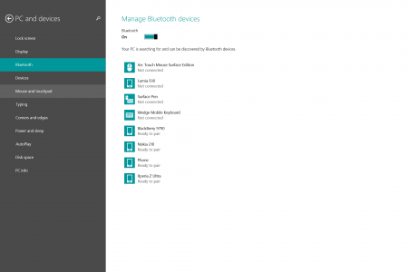

This is what you should see. If not, check your device manager for Bluetooth radios. If there is none there, reboot and check again. Failing that could be a hardware fault with the BT radio :/

To clarify: It's not like i can't see my pen on the list of bluetooth devices, there basically is no list. I can access every option as shown in the picture above EXCEPT "bluetooth". o_O There's basically nothing between "display" and "devices". I just restarted it again and there were some "features processed" so i kinda hoped this will fix it...but i was wrong...still have the same issue. No bluetooth menu anywhere. Holding the top button of the pen pushed and get it blinking doesn't affect it tho. :(
Do you have a Bluetooth radio showing in your device manager?
