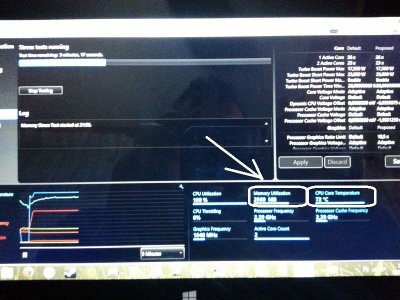

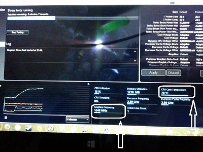

Testing Firmware 20/01/2014
Stress GPU test:Now 70º (1048 Mhz frequency)
Stress GPU test:Above 80º (998 Mhz frequency)
2 min (3 min remaining) [Total = 5 min]
10 sec. remaining
Only down 1 Mhz of frequency for mantained at 70º (Now 1047 Mhz - 1048 Mhz) (Above = 948 Mhz - 998 Mhz)

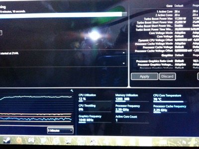

Stress RAM test:Now 72º
Stress RAM test:Above 80º
That's all,for now i am satisfied,i reached above 80° fast and now maintained at 70° without lowering the frequency

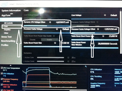

My Config Intel Extreme Tuning Utility
Config Core CPU : Dynamic CPU Voltage Offset = -6,8359375 mv
Processor Cache Voltage Offset = -1,9531250 mv

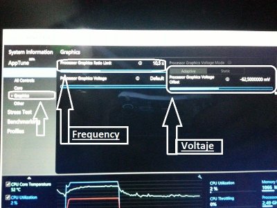

Config Graphics GPU : Processor Graphics Ratio Limit = 10,5x
Processor Graphics Voltage Offset = -62,5000000 mv
I played with this configuration for hours without problems, is stable.
