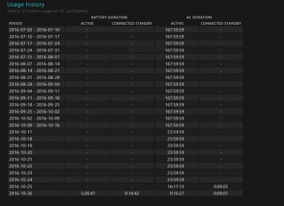

I bought a new SP4 from amazon.co.uk (2 days ago) and the battery isn't great. I did a battery report and it says its battery design is 38,152 but I think that is low. Also the battery report mentions under 'usage history' that is was on AC power during august-September active for 167.58.59. Do you think that is normal???

It says only one cycle that's what puzzles me. I don't know why the report mentions days between july and September in the usage history
even over such a long period of time? I have a screenshot here

the battery was not great over first two days, but lots of people have said that that can happen etc.
Windows 10 does a whole bunch of system optimizations in the first couple of days so I wouldn't be worried yet. Give it a week of the device being on and see if it gets better during that time.
