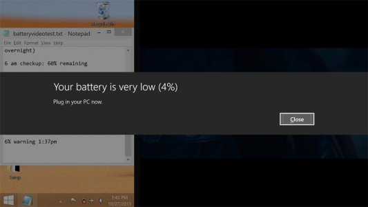

Settings:
100% battery, 35% screen brightness (this is within my personal normal range), sleep disabled, airplane mode, keyboard backlighting off. Volume set at 4 (since I didn't want it to bother me throughout the night and the next day).
Test:
Looped a movie off local drive with the built-in Xbox video player, fullscreen most of the time, split screen occasionally to jot notes into Notepad on the desktop.
60% remaining at 6:00 am.
32% remaining at 10:00 am.
6% warning at 1:37 pm.
Shut down at 1:47 pm.
Total run time: 13 hours 47 minutes
Comments:
I really don't know why, with wifi off and lower brightness, my test ended up shorter than Engadget's test, but who cares. This isn't quite an average use case except for transoceanic flights (thus airplane mode) and TV/film marathons, which would normally kill my brain anyway. So between this local video test and the wifi streaming video test, I expect my normal usage to fall between there. We'll see.
(Oh, and the screen looks darker than the test because it dims when the warning pops up.)
