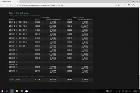

For the battery report you don't need to run it as administrator. At least that's my experience. I have a batch file in the desktop and just double click on it anytime I need it.
Would love to see how you wrote that batch file. That's a good little app to use.
That battery report is totally untrustworthy. I just ran it and I have under "Usage history" this line:
2016-07-07 1:11:16 0:10:24 0:52:42 592625:45:01
That last number there is supposed to be (IIUC) the time of connected standby while plugged in. Total nonsense!
And there are lots of other numbers that do not make sense, like:
2016-02-22 - 2016-02-29 19:27:53 489:52:21
where that last number is supposed to be battery duration while in connected standby. Note that there are only 192 hours in an 8-day period.
So when the battery report gives me an estimate of almost 6 hours, I say *bull*. I am totally unsatisfied with the battery life of my SP3 (and this is my second brand new and they both had the exact same problem).
This is SP3 i7/8/512, W10 Pro.
this is mine:
Code:
set DD=%DATE:~0,2%
set MM=%DATE:~3,2%
set YY=%DATE:~8,2%
set YYYY=%DATE:~6,4%
set HH=%TIME:~0,2%
set MN=%TIME:~3,2%
powercfg /batteryreport /output "%USERPROFILE%\Desktop\Battery Log\battery_report_%YYYY%.%MM%.%DD%-%HH%%MN%.html" & powercfg /sleepstudy /output "%USERPROFILE%\Desktop\Battery Log\sleep_report_%YYYY%.%MM%.%DD%-%HH%%MN%.html"
its a 2in1, if you run it as admin you also get a sleep study. Normal Batteryreport doesnt need admin.
my Batterylife estimates are pretty much true..... sadly -.-
