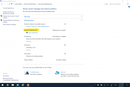

Seems Microsoft did something wrong with this build, I hope gets fixed next build. By the way after successfully booting to windows force run an Automatic Maintenance and wait for it to finish before reboot again. If goes again BSOD use F7 to disable the drivers signature again to be able to boot.
