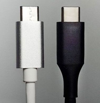

Look at the USB-C plugs shown in the image here. The one on the right is seamless; it was made using a relatively expensive "deep extruding" method of metal-forming. The one on the left shows a zigzag seam, indicative of metal that was merely folded into a tube shape and sloppily secured. The critical wiring inside is likely to be just as sloppy.

I have two USB-C cables that came with my Lumia 950 - they do have the left hand style of plug (with the seam) and that is the Microsoft supplied cable. It feels very good quality to me.
An informal survey of my collection of dozens of USB cables, sticks and devices shows almost all of them were made using the cheap metal folding of the connector shell. I say almost all only because I stopped checking and didn't look at every one of them but none of the ones I looked at used the expensive "deep extruding" method including the quality Anker cables I have. Oh dear better chuck them all and go buy some cables with deep extruded shells.
Note the construction of the shell in no way implies or guarantees the construction or quality of the actual cabling and connections of the wires to the pins which is where the rubber meets the road in a cable.
