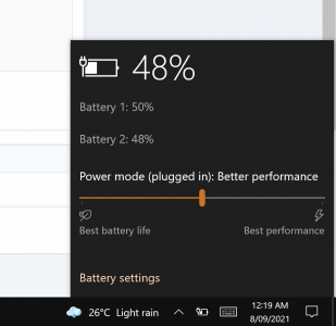

Most of the time i use laptop with charging connected. My cycle counts are 8 tablet and 22 for base.
Recently when i used the tablet disconnecting from the base, i saw a drop of 50% within 30 mins.
I thought having 100% charge on tablet for long period may have damaged the battery.
So i enabled battery limit in boot settings.
Now, My SB2 no longer charging.
Is there any alternative to this Battery limit feature that would cap charging to 80% despite connected to power for longevity of the battery?
