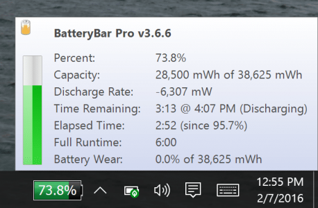

I am seeing something strange with my SP4 as of lately. Maybe someone can make heads or tails of this.
I have BatteryBar Pro, and it says I'm connected to A/C, and then shortly after it'll show me the time I have remaining (when already charged at 100%).
So I ran a battery report and this is what I saw...
In regards to battery bar pro, this is what I'm seeing:
It'll cycle between these two... And then actual Battery Bar Pro upon hovering over it shows:
and
Can anyone tell me if this is hardware related or software related? I have two OEM chargers, and they both show the same thing. So I know it's not the charger itself.
Update: Issue is gone, I thought I'd let everyone know what has changed. What I did was uninstall Battery Bar Pro, and then restarted, and reinstalled it again. What I believe happened is that since the last firmware update that MS released, which contained some new drivers for the battery and charging, conflicted with the BBP drivers. So I uninstalled, and reinstalled, and I haven't seen this issue yet.

So you don't think this is worrisome? I mean, nothing is wrong with it? On my last Surface Pro 4 I had battery bar pro hide itself when it was at 100%, and now it appears and disappears constantly... I changed it to just always show, but I know this wasn't there on my last SP4. Could this be a hardware issue?

Yes, it looks like it disconnects from the AC and then runs off of battery for 10 seconds to a minute (depending if it's on or in sleep mode) and then back to AC.

Uninstall Battery Bar Pro and see what happens after 24-48 hours after you run the report.
It could just be a change in behavior as I believe there was a recent change to "battery charging"
