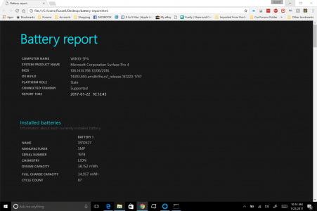

First port of call would be to run battery report (How to generate a Battery Report in Windows 10) and see what your batteries current capacity is. You can also open task manager and see if there are any processes going on in the background that are using significant resources.

Screen shot. Hmmm

I just got off Microsoft Support and they said due to the battery tests, it seems the battery isn't getting a full charge. They are replacing it.
