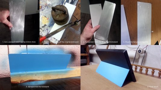

Spent a couple of hours in the workshop trying to make the 3D printed kickstand stronger. Found a piece of sheet metal (i think it's steel or aluminum approx 0,5 mm thick) filed it to the right shape and glued the pieces together. Turned out really nice and strong.

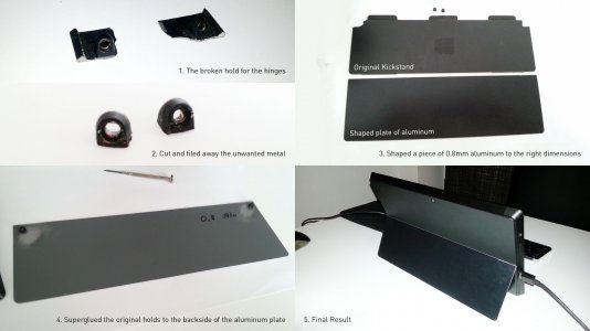

Tomorrow i'm gonna take some parts from the original kickstand (the small pieces connecting to the hinges) File them a bit and superglue to an new piece of metal of the correct shape and make another one. Will post pics of next project also.
Wow fantastic job though... seriously
I tryed another fix to replace the old broken kickstand. This time i used the hinge hold from the original kickstand and simply superglued them to a new plate of aluminum. Fit perfectly, and looks awesome. Planning to spraypaint this kickstand as well when i get a chance. Hope this can help others also if the want to make a quick and functional fix. (!) IMPORTANT! - If you superglue the holds & to get them perfectly aligned, FIRST screw them on to the hinges at open position, add a small drop of superglue to them, carefully align and hold the new kickstand in place for a minute or so. When the glue has fixed, carefully remove the kickstand again. Add some extra glue around the edges of the holds, to fix them even stronger. When completely dried, screw on the kickstand again... ;) Good luck.
