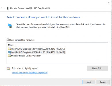

Roll back the Intel Driver, every time I've attempted to install the updated driver it has caused problems. I had to uninstall and delete the driver and then reboot.
I just did the rollback successfully. Thanks
Where is the driver located to be deleted? I still have it installed
Please any advice on how to remove the intel drivers will be appreciated, thanks
If it rolled back you should be fine - otherwise from device manage right click on the device and chose uninstall and check the box that says delete the driver...
Thank you VERY MUCH Jeff for all you help, everything is good now
