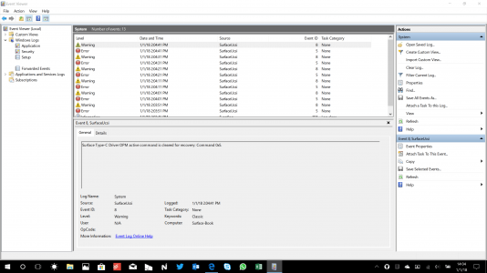

Something happens on my Surface Book 2 that suddenly today I started seeing the following Warning/Error message on Event Viewer, the exact same 2 messages will be triggered every 10 seconds exactly and they are non-stop. I restarted the SB2 without any results, the messages keep happening, A day ago I did not have any. How can I stop them and fix the root cause. Thanks
Surface Type-C Driver OPM command sequence timedout: Command 0x5.
Surface Type-C Driver OPM active command is cleared for recovery: Command 0x5.

What do you have plugged into your Type C port?
Weird - I got the same when I had a the Lumia 950 Continuum Dock plugged in - but only one instance. Do you have any pending updates?
Everything is up to date with Windows Update, I just ran the Surface Diagnostic Toolkit and fixed it, very weird, I do not know what the SDT will do, but maybe there was something (driver) corrupted and it fixed it, :)
Everything is up to date with Windows Update, I just run the Surface Diagnostic Toolkit and fixed it, very weird, I do not know what the SDT will do, but maybe there was something (driver) corrupted and it fixed it, :)
Excellent - marking as solved...I saw you posted this across the web it would be good to go back and close the loop on Reddit, Answers.Microsoft.com and any others that you posted on...

Same problem here: Surface Type-C Driver PPM availability notification failed, PPM availability state = 1.
In the Device Management, "Surface Ucsi Device" says: Windows has stopped this device because it has reported problems. (Code 43)
Can't connect to my external monitor, Surface Diagnostic Toolkit did not fix it.
Updated to the latest version of Windows did not fix it.
