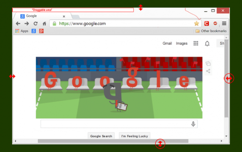

I was playing around with my displays today and made my SP2 secondary and my monitor my primary display. I noticed when I did this I could not resize Chrome from the bottom or right side of the window on my monitor. The resize icon appeared but it would go away when I dragged away. I noticed the top and left side did work which I thought was odd. So I tried dragging Chrome to the secondary display (my surface) and noticed I did not have this problem. I decided I didn't like this setup anyways so I just duplicated my surface screen so both displays were primary. Well now I can't resize from the bottom or right on either one. Additionally, the area at the top of the window where you can drag it has been reduced to a smaller area.

Your windows borders look unusually thin to me, I don't know if it's Chrome with its god awful, outdated GUI engine selected, which overlays on top of the borders, or you made Windows borders thinners.
Go in the registry (Start > type: regedit > Enter), and go to HKEY_CURRENT_USER\Control Panel\Desktop\WindowMetrics, and look at PaddedBorderWidth . Make sure it is at value -60. If it's not set it to that.

Thanks for replying GoodBytes! My registry is just like you say it should be. I shrunk the screenshot down to fit here, that is why the borders look so small. I did a soft recovery (the one that keeps your files) and it seems to have fixed it. Unfortunately it's going to take me all day to reinstall software. Still not sure what caused this but hopefully it doesn't happen to anyone else.
