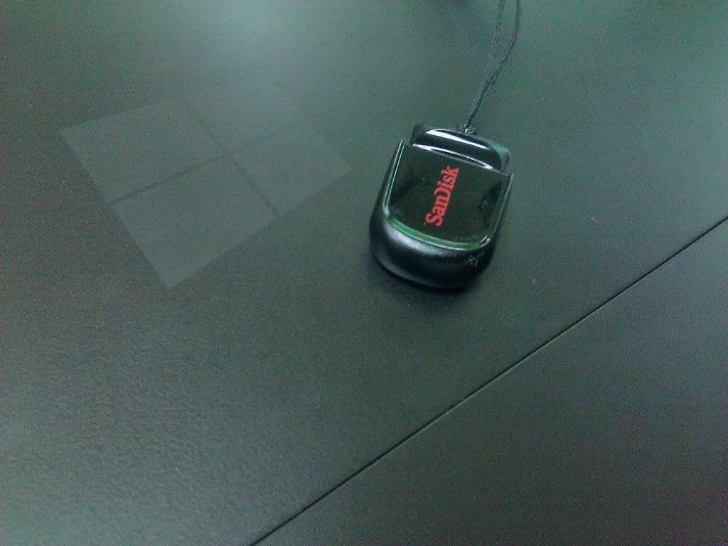

This is what I am using-
I have that USB drive as well, but it is the 4GB version. Still, it does the same thing when I insert it (progress bar animates, but it still stays stuck on the Connect USB drive screen).
