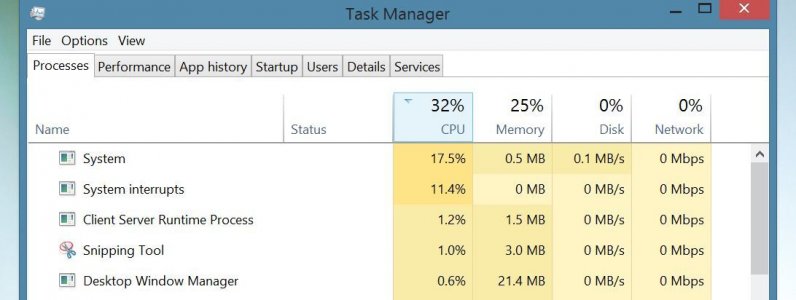

So I've posted this in a few threads but wanted to call special attention to this problem since my brand new 100% stock replacement SP2 is experiencing the same problem and it was suggested this may be a universal (all SP2s) problem
Frequently, my SP2 with nothing running will idle with 3 core-processes using up 30% of my CPU. This causes the device to get hot and experience battery drain when nothing is running. Capture.JPG
I've spoken to support whose reasoning as to why I should not request another replacement was as follows: This is your second SP2 which still experiences the same problem so please wait for MS to release a patch for this known issue. This leads me to believe that if the support rep has concluded that a further replacement will not fix the issue that this issue is more widespread, perhaps universal to all SP2s. Windows Update shows that it did grab the 1/18/2014 System Firmware Update btw.
I do know that this issue may be due to the Realtek audio drivers and can be remedied by disabling it in Device Manager (not ideal, as you will not have sound) People tend to think this is related to SD cards installed but this is not the case as I get this issue with/without my SD card installed.
So I ask the community here and those experiencing less than ideal battery life to open up task manger when your device is seemingly running warm for no reason and see if System and System Interrupts are chugging away for no apparent reason, thanks.

While that taskmgr view looks mighty familiar, in my case, it was associated with startup with the mSD card in the slot. Without the mSD card, it would settle down to near 0% CPU utilization.
I discovered putting the SP2 to sleep and waking it up even half a second later would stop the high CPU use, which dropped to near 0% as expected. Don't know if this "trick" would work in your situation.
The Realtek audio drivers are enabled on my SP2, but don't know it matters that most of the time sound is muted. I also recently saw a post in this forum (somewhere) describing uninstalling/reinstalling Realtek drivers (from the Realtek site) which resolved processor utilization issues. The drivers on my SP2 are version 6.0.1.7038 (2013-09-11). Could be earlier/later ones are problematic.
If you find disabling the driver solves the CPU issue, seems that updating the drivers would be the next thing to try.

To be clear, this is not the traditional sleep to hibernate issue, as this has been fixed by the 1/18/2014 firmware update. It appears to be an issue resuming from hibernation/sleep with the SD card installed that causes the CPU utilization. Removing the SD card after has no effect as whenever any sound plays, utilization dips momentarily. I've tried the newest Realtek drivers from their site on my previous SP2 with no success. Can anyone try to replicate resume from hibernation (not sleep) with SD card installed (where you get the new device rediscovery sound and brief progress bar of the SD card being found soon as the system resumes) to see if they experience this issue
Again, my main concern is whether or not I have another lemon and need it replaced. Microsoft support suggests "no" and to wait for another patch which seems absurd on a stock (plus SanDisk Ultra 64GB micro SD) device if the problem is not more widespread.

Yes I can replicate this every time by resuming from hibernation with the SD card installed, CPU does not go up with SD card out on resume from hibernation. Thanks for the insight! So... people with SD cards, force a hibernation "shutdown /h" and resume (power button) with SD card in, do you get high CPU utilization? (22% on Balanced, 30+% on High Performance)

See the top issue here: Surface Pro 2 Issue List - Microsoft Community, lots of reports of the same issue, think it's been know about for a while.
Likely compatibility with your SD card, not a dud surface that a replacement would fix so maybe try a different card while wasting for MS to get into gear.
