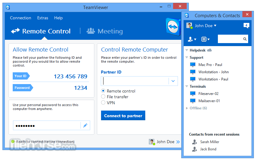

  • Team Viewer (will need a server on the SP4 and client on the SB2)
