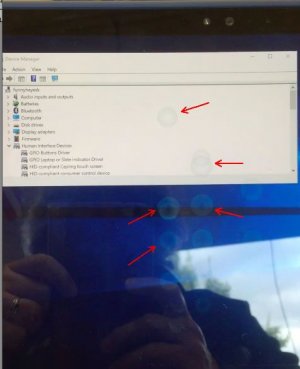

Similar question...
I work in a school with 270 new SP4 Tablets. Three (so far) units are responding to touches that aren't there. I have cleaned the screens, uninstalled and re-installed the touch drivers, uninstalled the HID devices and re-installed, updated firmware, calibrated the screens, and all three units are fully updated in terms of the Windows software.
I've attached an image (it was part of a video) that shows me attempting to disable the HID touch devices so the student can still use the Tablet as a laptop. It took me five minutes to do so because the touchscreen is responding to literally 100s of touches per minute.
So the question is, what's next? Is there a possibility it's a software issue or shall I take it to my local MS store and have them do a hardware swap? All units are still under warranty.
