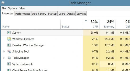

Just a heads-up, over the past 2 days I've been getting random high-idle CPU (System & System Interrupts) Weirdly, I randomly receive 6/10/14 firmware updates every so often even though I completed the update when it came out on 6/10.
EDIT: After rebooting several times this happened on boot, I've seen it a few times since the last 6/10 update which I received "again" on 6/29 and is only the System process; sound events do not affect this runaway process as before:
I had a similar runaway system process that was unrelated to the SD card issue and unaffected by sound events. I "solved" it by disabling the two MemoryDiagnostic tasks in the task scheduler.
I have not had any occurrences of runaway system process since I disabled those tasks (several months ago). Also, I have had an SD card inserted since the last update without any issues.
