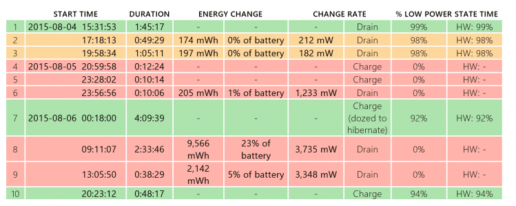

2, Power- I pressed power button once and placed surface in my bag 3 hours later I took it out and it was nice and warm NOT hot. and battery was totally gone.
I'm not actually sure I understand the power situation, so I'm coming to this thinking of it like a ipad rather than a laptop but I want to be able to put in 'standby' and in a bag and it not heat the bag or run through battery in a few hours!
is the behaviour above typical?
thanks
ps other than this I'm loving it so far.
image showing use

The power button on the SP3 has always been one of my biggest gripes, and has been the source of many complaints by other users as well. It bumps on practically everything, so unless you have it in a case or some manner where the button is physically protected, then yes, if you close the cover or do like you did, and then just tuck the thing away in a bag or whatever, then you can almost guarantee that your SP3 WILL get powered on in the bag. It's an annoyance but I basically shut mine completely down now before leaving the house, which is almost every day, multiple times a day. I truly hope that Sp4 has recessed/ inverted power button.
