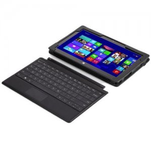

One other solution is to get a case with a removable insert like this one and it buffers your hands from the heat:
Amazon.com: MoKo Rotatory Detachable Type Cover Companion Sleeve Case for Microsoft Surface Pro 10.6" Inch Windows 8 Tablet, BLACK: Computers & Accessories
