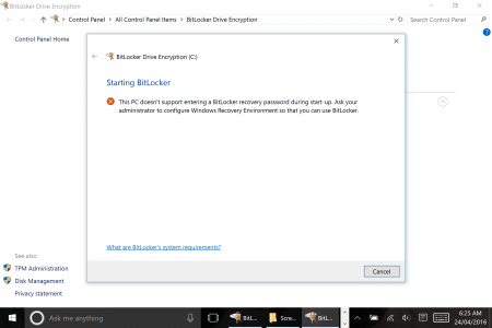

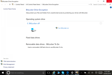

Hi guys.
Yesterday I did a clean install of Windows 10 and the wizard asked to turn of bitlocker on drive C before the installation. After that I could not turn it back on.
Kind regards,
Tatletz

How did you create the partitions? Also, try loaded the default secure boot keys in UEFI. If worst comes to worst, download the recovery image and load that...
Hi jnjroach, I didnt touch the partitions. When the installation started it asked to turn off bitlocker from control panel then proceed with the install. I formated drive c(something I always do with no issues after that) and proceeded. I dont know how to load these secure boot keys. I downloaded windows 10 recovery image and reseted my surface pro 3, but problem still there. Also tried to recet it with control panel recovery drive but no luck.
Any help will be sppreciated
Thank you!
Thank you!
Power down and hold the volume rocker up and power up, go to the UEFI Screen and you can load the default keys from there....
In UEFI screen there are several options and under secure boot control is "delete all secure boot keys" So what should I do, can you be more specific please. My surface otherwise works fine, not sure if I miss something by not having bitlocker on.
Thank you!

Did all this, enable/disable secure boot control, delete then install secure boot keys(both windows only and windows and 3rd party options) reboot and having the same issue. Apparently there is some registry keys solution but not sure how to do it.
I should asked this first, are you using a local or MS Account?
That is weird as you are showing that S0iX is enabled and can work on a Bitlockered system....
