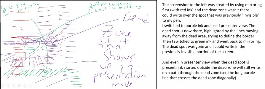

Edit: I've uploaded a screenshot of a PowerPoint slide with some notes on the right about how it was created. The deadzone (while a bit confusing with too many lines) is prominent with the purple ink and the lines pointing away from the dead zone that create the boundary.
