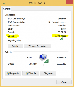

You can determine connection speed by opening Control Panel, view network status and tasks, change adapter settings, press and hold or right click the adapter and select Status.
What is the connection speed of both the SP2 and SP3? This may fluctuate a bit hopefully not a lot.
