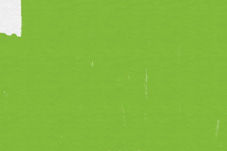

Use a drawing program and put it full screen. Paint the entire surface up to the point where it doesn't detect touch input and post the screenshot here.
Attached. Okay, something is weird. I did this earlier today and the dead area was twice as big.

The area was so big earlier today that I couldn't click on first tile on my start screen unless it was the bottom right part of the tile. Is it possible the screen might have been compressed during shipping and now is relaxing or something?
Regardless, it still isn't being detected in that upper left area. I'm guessing the screen might have been replaced, but there was a fault in the touch sensor or it was replaced incorrectly causing that part not to be usable.

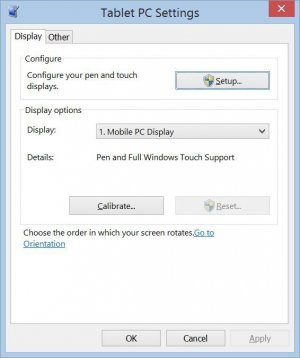

As jnroach suggested, try just pressing the reset button when going to calibrate it. Don't actually try to calibrate it. This resolved my screen issues. For some reason only resetting the calibration works not actually recalibrating it.

Don't calibrate just reset.... calibrating touch is a leftover from Windows 7 and is detrimental to Windows 8.x devices.
Never had the option to reset, this is a capture of the window that I get. Unless there's something else?
