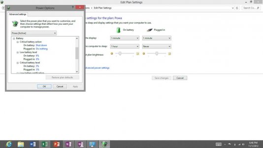

Don't know if you can change the setting here for the low battery notification, but you can definitely change what low percentage for "shutting off"
Go to desktop -> battery -> more power options -> (you can add power options!) advance settings -> battery
