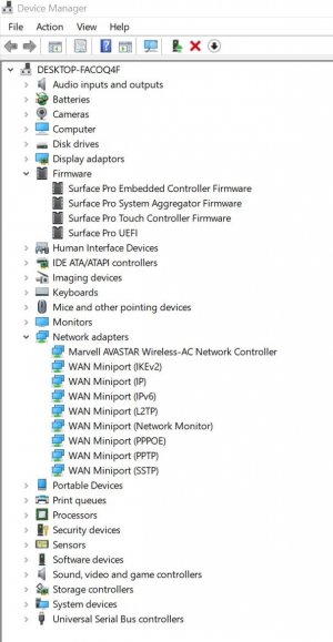

My SP3 is not finding any WIFI networks and Bluetooth is not even seen as 'on'. This is the second time that I am having this issue - last time a full system reset fixed the issue. This time around, I am now at my third consecutive reset and the issue remains.
In short, my Bluetooth adapter is not showing up in the Device Manager listing (attached) while the Network adapter is coming up as fine. I have tried:
  • multiple driver updates from the MS official lists and still no fix.
  • reset WIFI/Bluetooth in UEFI and no fix.
  • rolling back Marvell WIFI adapter drivers and no fix.
Is this a common issue and is it indicative of a hardware fail?

I wasn't clear - both BT and Wireless are dead - only difference is that Wireless adapter is showing and I can try different drivers and uninstall/re-install.

Definitely can still use external adapter(s) - while it would be extremely inconvenient and in the way (primary use of the surface is note taking at the moment), that should keep it going.
I was hoping for another solution, and definitely hoping that it was not a hardware issue with the SP3
