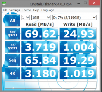

look at how poor these scores are, and I can notice how much slower it is to unRAR a file on this 128 SD card compared to my 64GB card
The thing to remember about SD cards is that they were designed for cameras originally. The really really fast SD cards that are coming out now that are class 10 are rated like that because they can handle the relatively large photos that newer cameras can take. They may be large files for photos, but they are small in comparison to files you are thinking of using the sd card for.
The most expensive fastest SD cards out today that cost a lot of money are the u3 class 10 cards. That means they have a 3 inside the U on the card and then a 10 in a circle. While manufacturers love to advertise maximum read speeds, us consumers should be aware of minimum write speeds because that is what really matters.
A u3 class 10 card has a minimum write speed of 30mb a sec. The typical u1 class 10 card that you see at the store indicating 90mb/s is max 90mb/s read and minimum 10mb/s write. Thats extremely slow.
