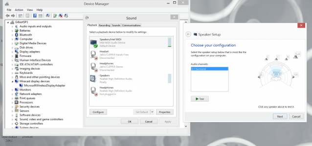

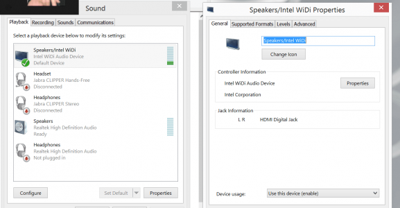

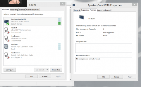

Here's some screenshot from device manager:

As for your situation at hand, from p.29 of your system’s manual regarding audio settings:
When [Digital Output] option is set to [PCM Multi-Ch], the audio may output as PCM Stereo if the PCM Multi-Ch information is not detected from HDMI device with EDID.
You didn’t mention the make of your tv, but most only carry a stereo (2ch.) decoder. It sounds like if this is set to something other than PCM stereo, your AVR will revert to your tv’s EDID and output only stereo sound. Check to see that you have the correct audio setting.
