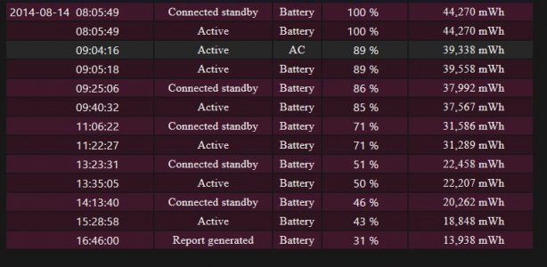

This is my battery usage for today. I attached the battery report I just ran.
I turned on at 8:05am this morning, right now it's 4:51pm and I have 30% battery left. I used the actual SP3 screen for a few minutes this morning, but I have it plugged into a Plugable UD-3900 dock connected by ethernet and am using dual 22" Dell monitors.
Not bad if you ask me.

Tweaked a lot of settings and have been using the screen at a reduced brightness (40-45% ?). showing about 6-7 hours of battery time, so it is indeed possible to get much higher numbers.
I have not used external drives or done ANY high processing work. Screen is set to turn of at 3 minutes and hibernate at 15 minutes.

After I turned off notifications running in the background my battery life jumped to 7 hours from about 5 hours and I use brightness at about 35%. Honestly I couldn't do full 100% brightness, even when plugged in, it's way to bright for my eyes.
. What did you do to turn off notifications?
You may want to note that in your battery thread. Notifications means something is going on.
